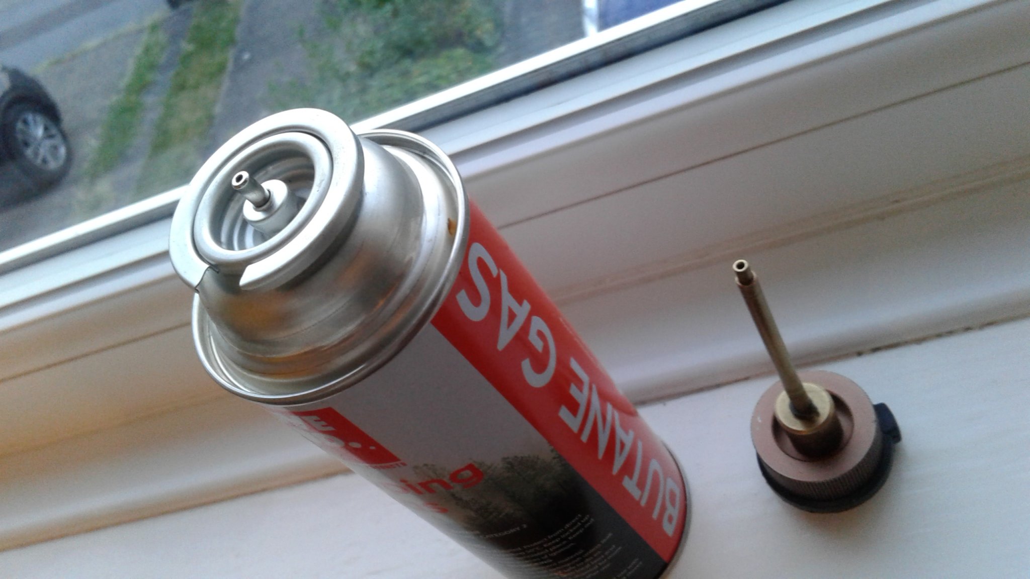

These are what you want, the gas cylinder was part of a 6 pack & cost aboutility £1:50, the adapter was bought from Tracks hack (I think )

There are these plastic ones too but shorter. They fit the disposable camping stove cans as above.
The adapter that Paul shows is available from Amazon, about £9.00 for 2, seems to work well with cheep gas cans.

There can be a large difference in quality too. The canister in pic #4 isn't too bad, but there are some brands that won't burn nicely at all. I have absolutely no idea why, to me gas is gas, but I'm sure someone on here can explain
