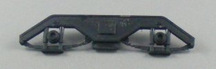

You don`t have to buy a 3D printer. There is an on-line group called 3D Hubs who will print your designs, in your area, for a sensible fee. They are just a co-op of home 3D printer owners, people just like you and me, who make a buck by printing for other people. If you go onto the 3DHUBS web site you can search your area to see the options. This works well for G scale and for doing test runs in the smaller scales. For final runs in the smaller scales (HO/OO) you need to spend thirty pounds or so by sending the job to Shapeways.
Stockers,
I have use a UP2 printer for over two years and have used the free Google SketchUp all that time. It is simple, intuitive and works for me. Yes, 3D design does take a lot of time.....but, for me, it`s a lot more fun than sitting watching TV.
I have attached a photo of one of the bogie sides which was printed on a UP2.
Regards
Peter Lucas
