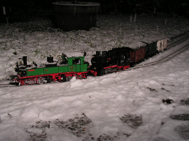

All still work with minimal maintenance. There are four point motors under the snow in this old image. Not posed, the train was running!

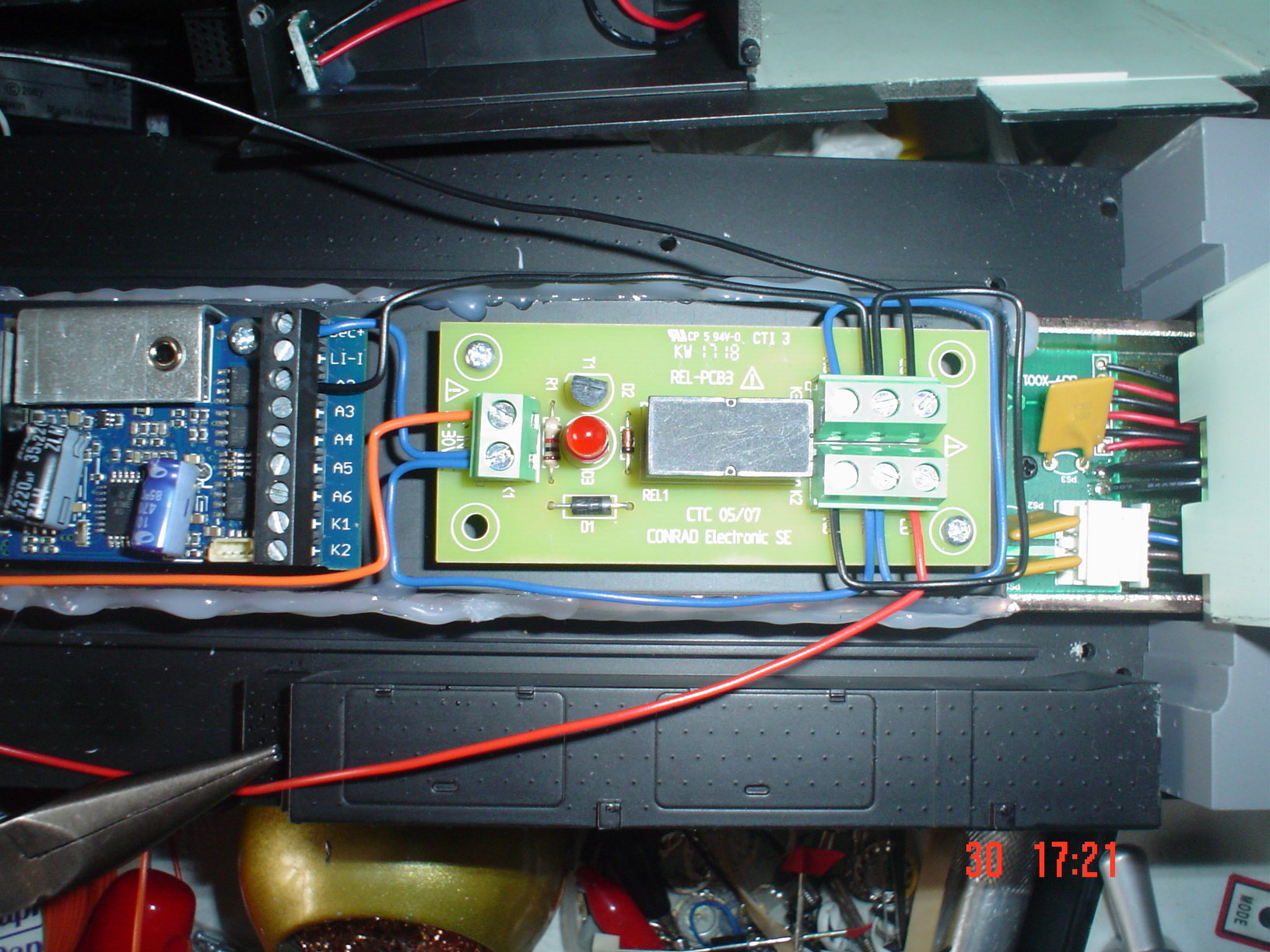

You can certainly run in light rain.. You do need to be aware of the general construction of your loco's though.. - Example would be an American outline diesel.. these have large grill areas where the cooling fans would be.. It may well be that any decoders / sound-cards / RC receivers may be mounted below these?? Rain (or any water) directly onto electronics is obviously not a good idea.

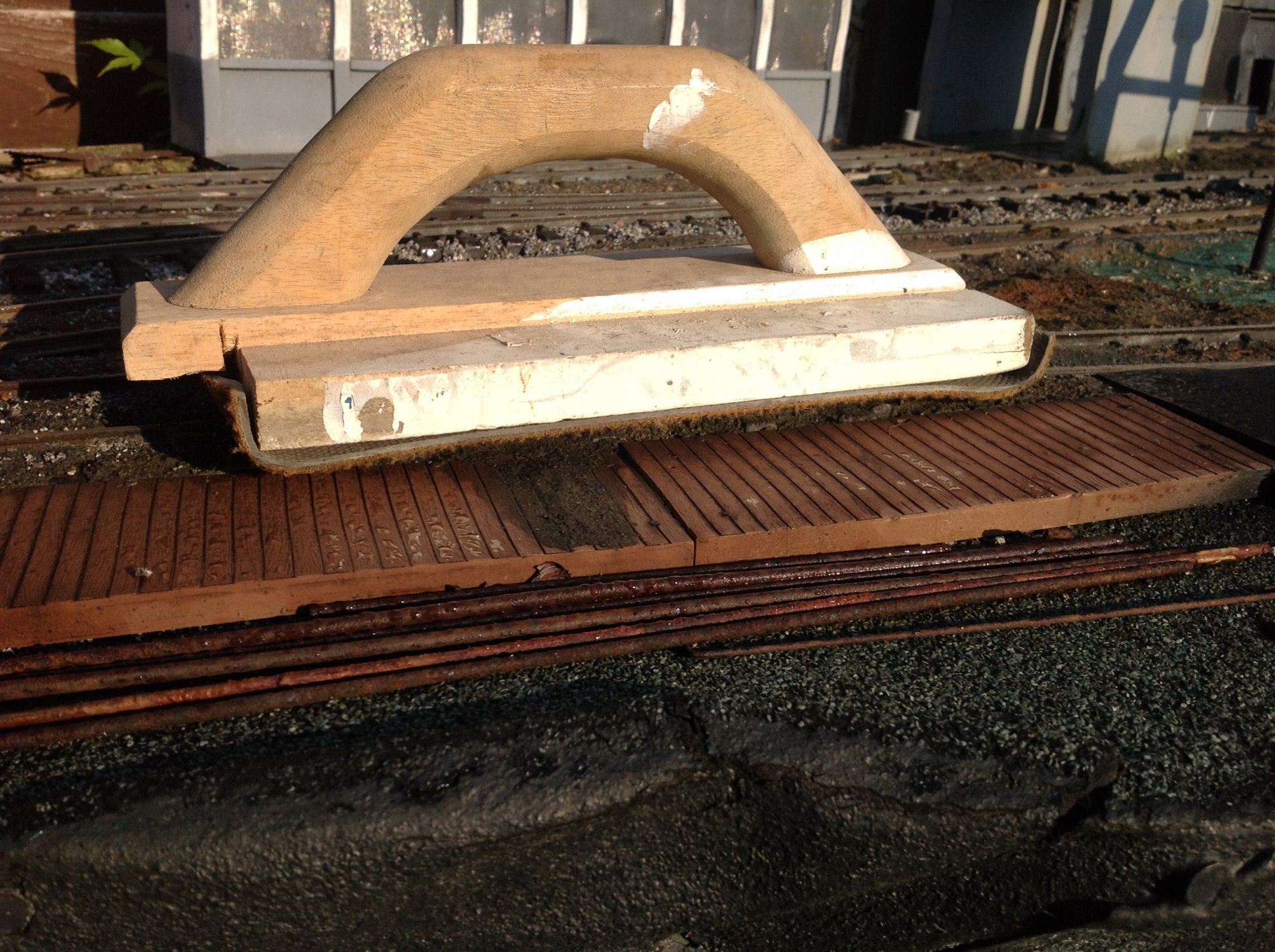

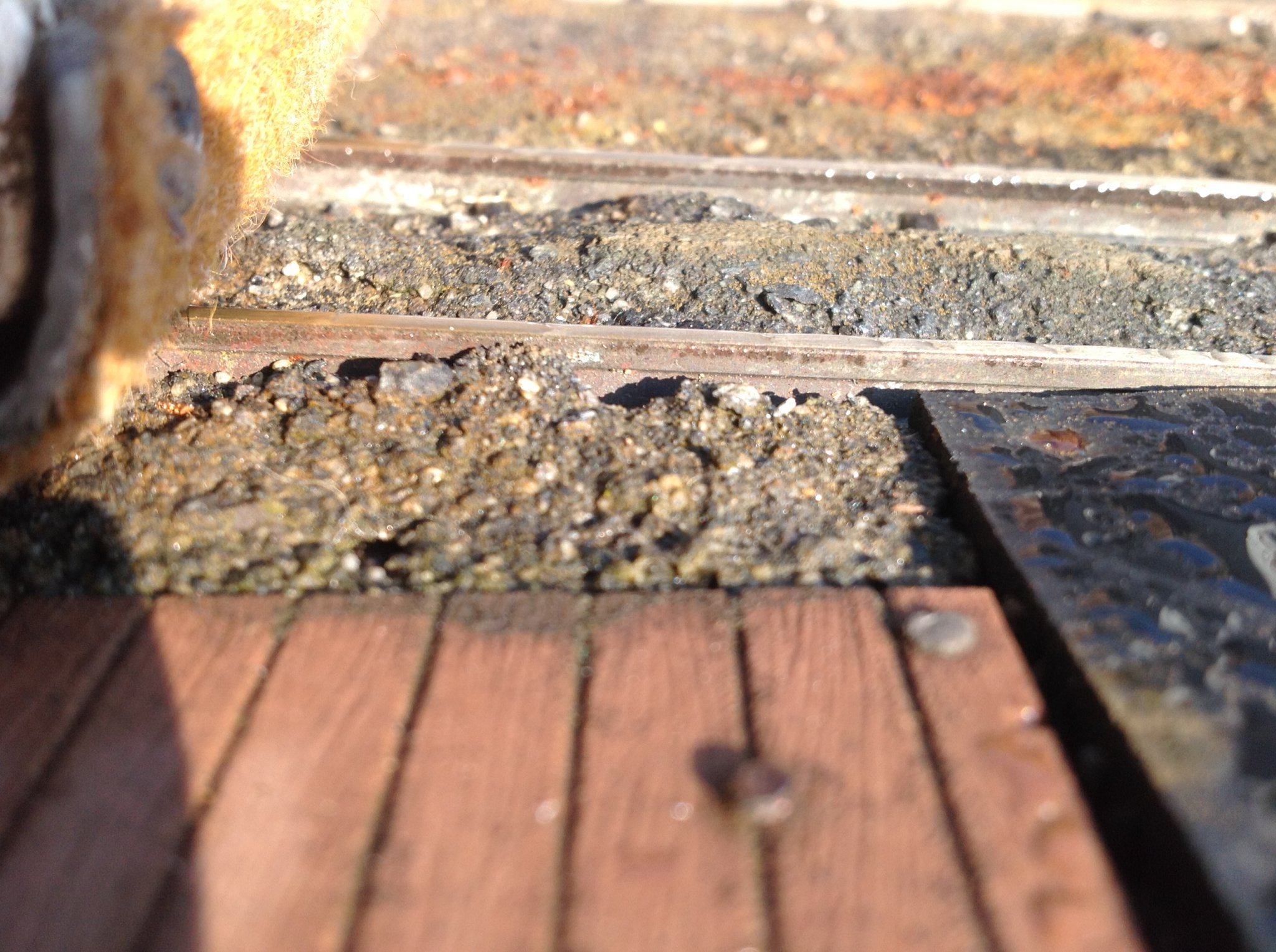

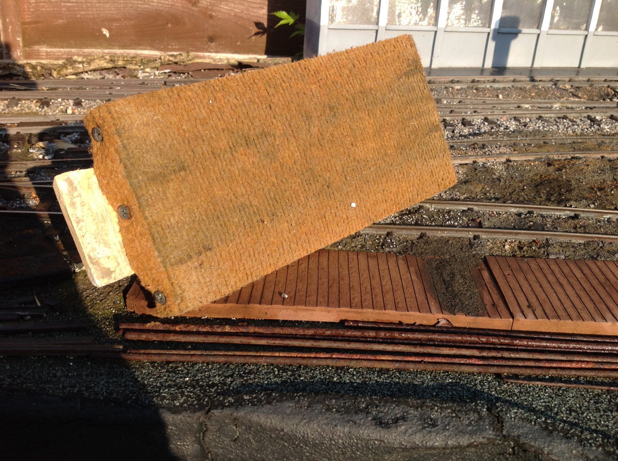

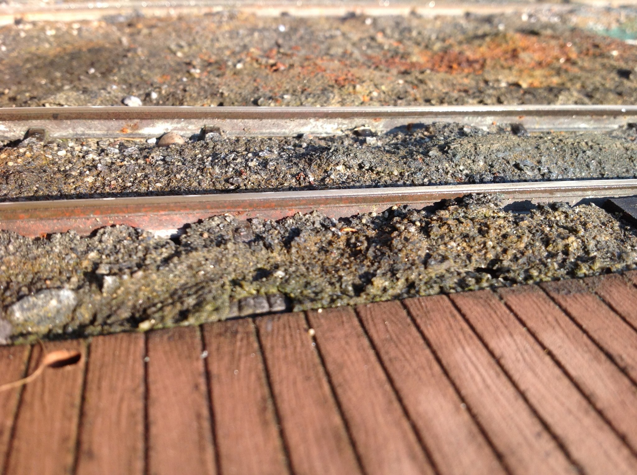

Much of this is contrary to my experience of after rain effects. First I find that some rubishy dust etc gets thrown onto the track causing glitches in sound and DCC Signals to the trains. Second a wet rail also causes glitches in sound and signal as well. If I am in need of running outside after damp conditions, not just rain but morning dew as well, I have an old Plasterers Thingimybob with some carpet on which I use to clean off both problems from affected area's.
The Thingamybob
Old Carpet Tile used as cleaner. Not professional fixing of this! Just 3 screws.image.jpegWet Rail this morning after dew, hope you can make it out.
As cleaned by Thingamybob
You do see 16mm live steam boys using similar devices, they use them to remove not only dampness on the rail top from live steamers but dumped oil as well which causes no end of Traction problems for them.

If after-market electronics has been fitted, then they may not be as robust in the wet..
As an example:
US outline diesels have big grilles, where cooling fans would be.. Quite often the amount of electronics required means that boards are under this area. - Something to be aware of..
The Thingamybob
Old Carpet Tile used as cleaner. Not professional fixing of this! Just 3 screws.View attachment 237690Wet Rail this morning after dew, hope you can make it out.
