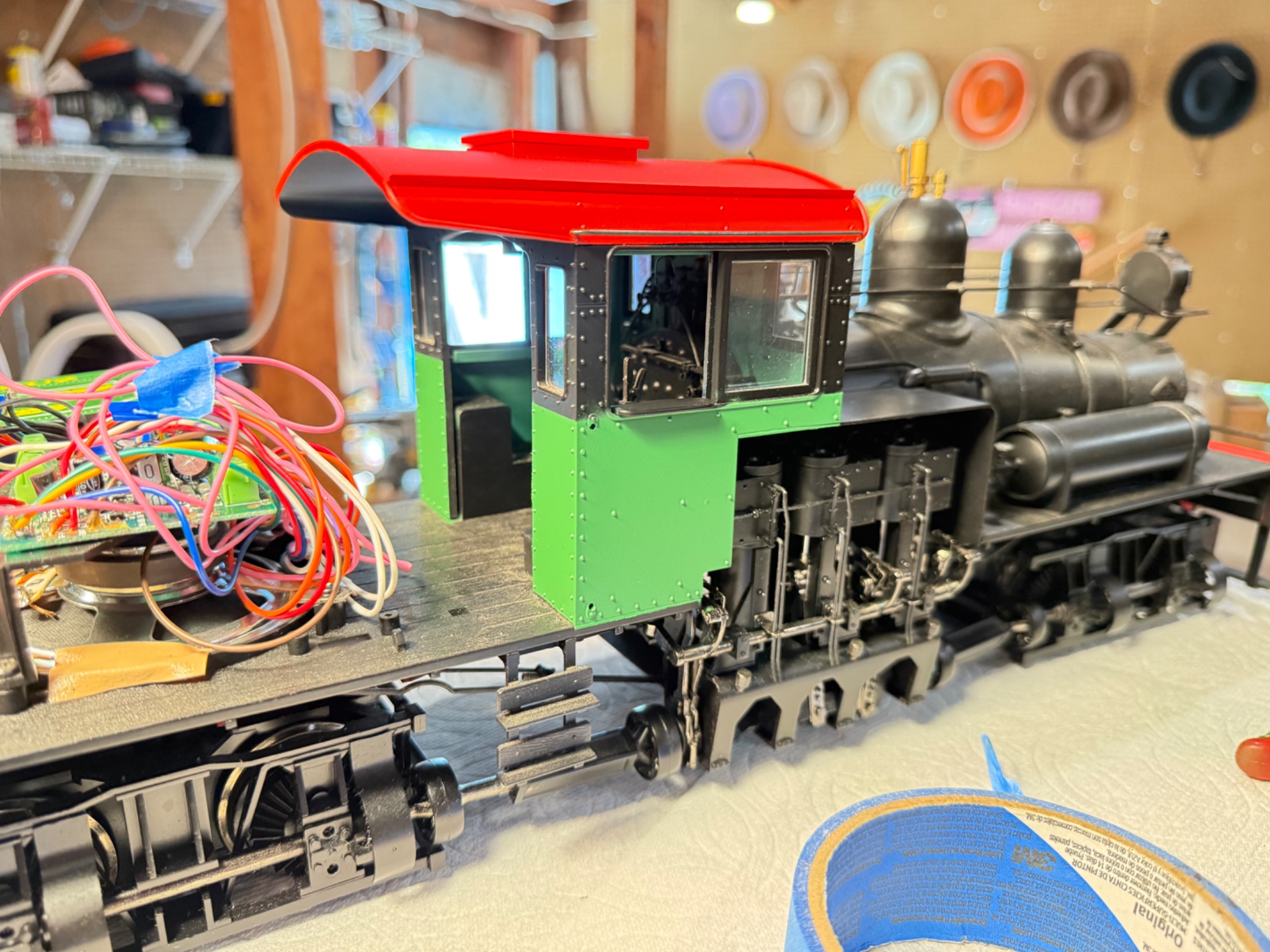

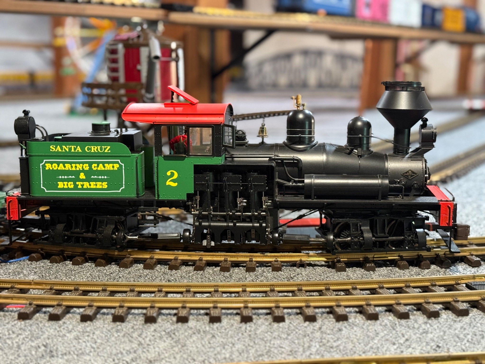

Just completed a project to paint and apply graphics to my Bachman 2-Truck Shay. Sent sample pictures to Highball Graphics and they delivered decals that exceeded my expectations within a week.
I had to use AI to read up on applying graphics specifically on an uneven surface. The side of the tender has raised rivets and the decal needed to be applied over them. I used Mr.Mark Setter as the base to help set the decal on the model, and then applied multiple coats of Mr.Mark Softer to basically melt the decals over the rivets. I finished off with Mr.Super Clear UV Matte spray.

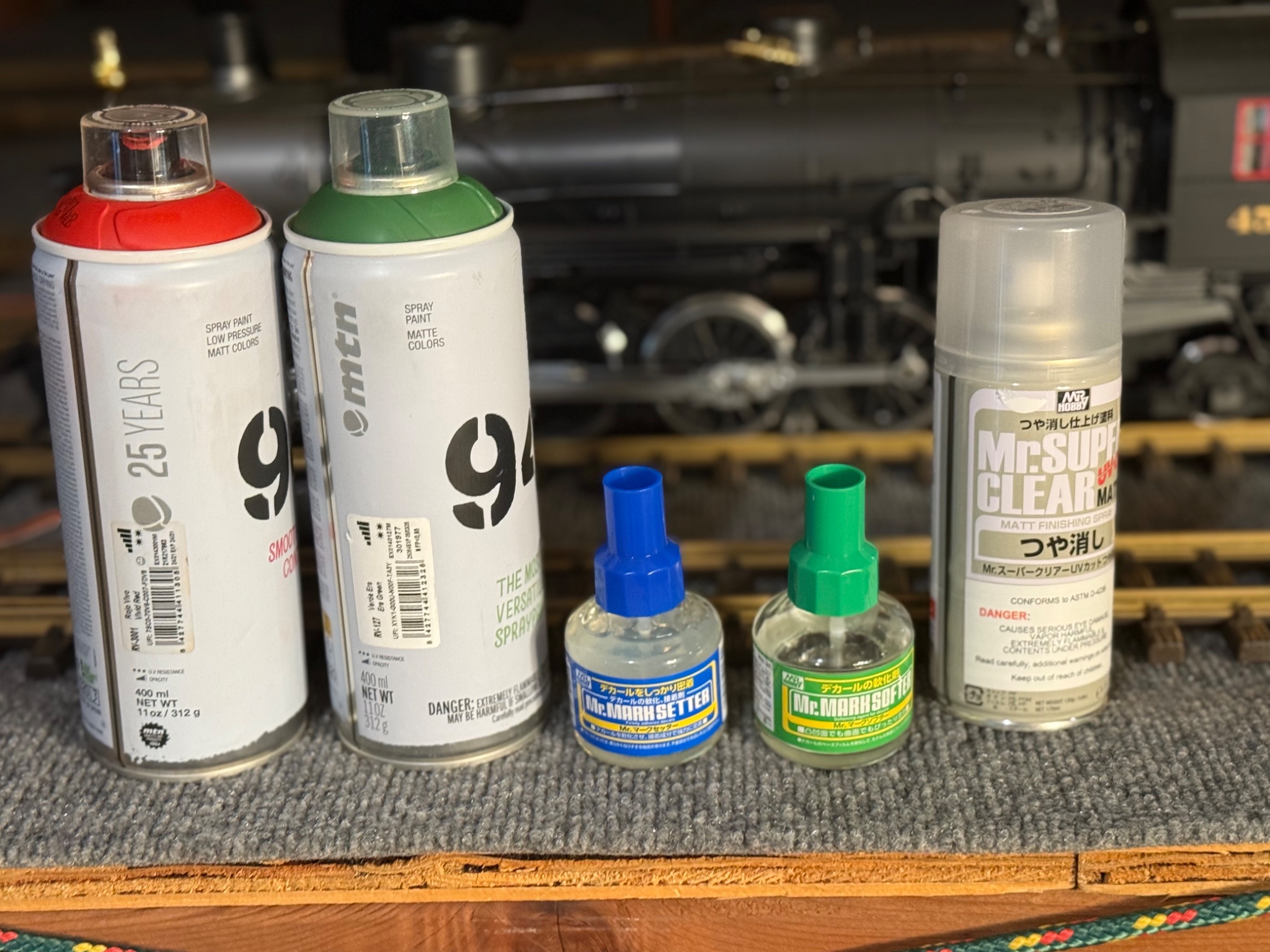

Here’s a photo of the products I used.
Haven't seen those in the UK but have similar stuff on the bench. I'll get around to it soon....
The two decal liquids are from the 'Mr hobby' range, they make an amazing range of modelling products.
