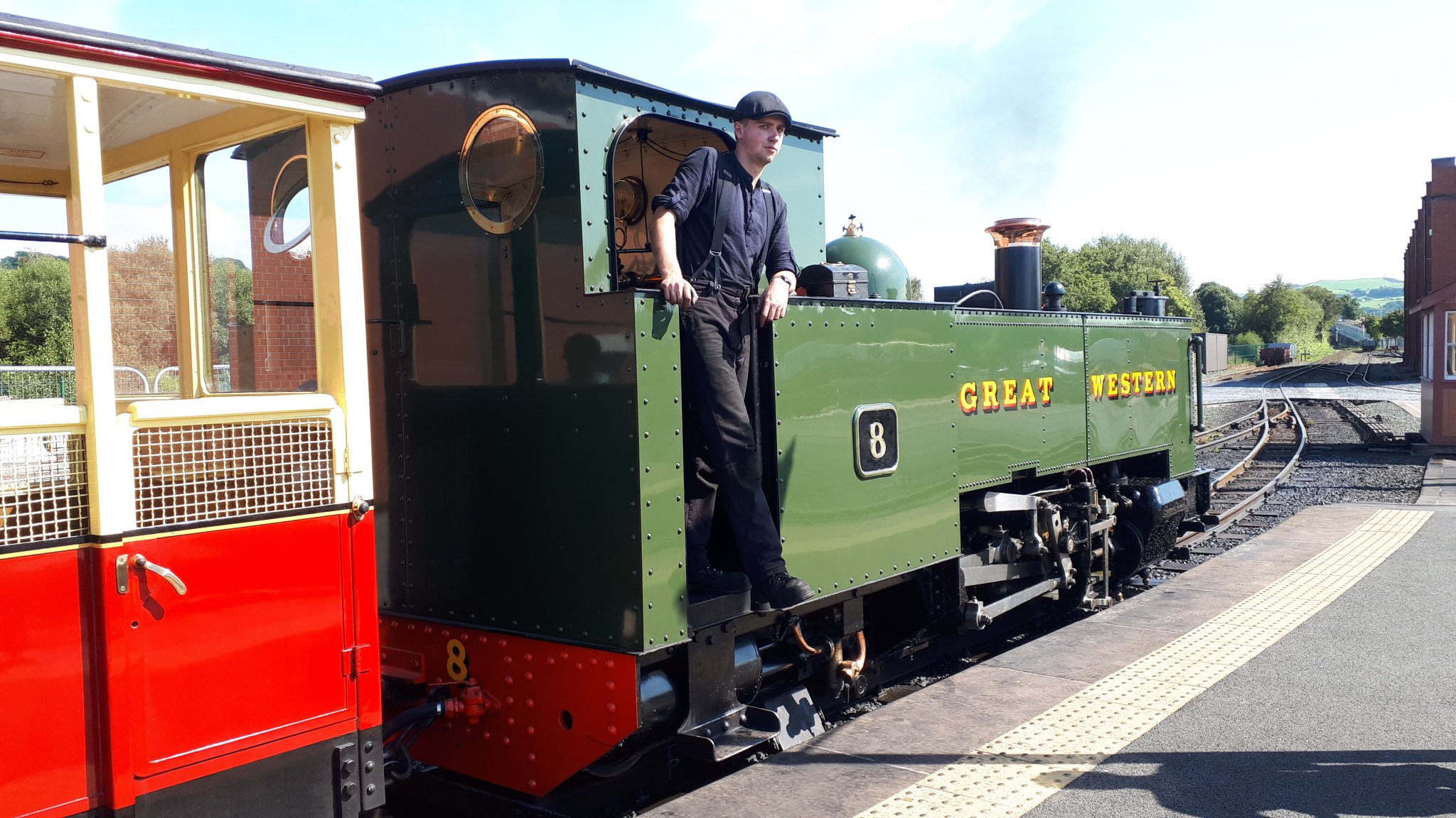

Having seen both these locos in the metal this year, I can confirm that the VoR loco is much bigger than Russell (in its current form).
Certainly, the VoR locos are quite wide, wider than the coaching stock that they haul....
