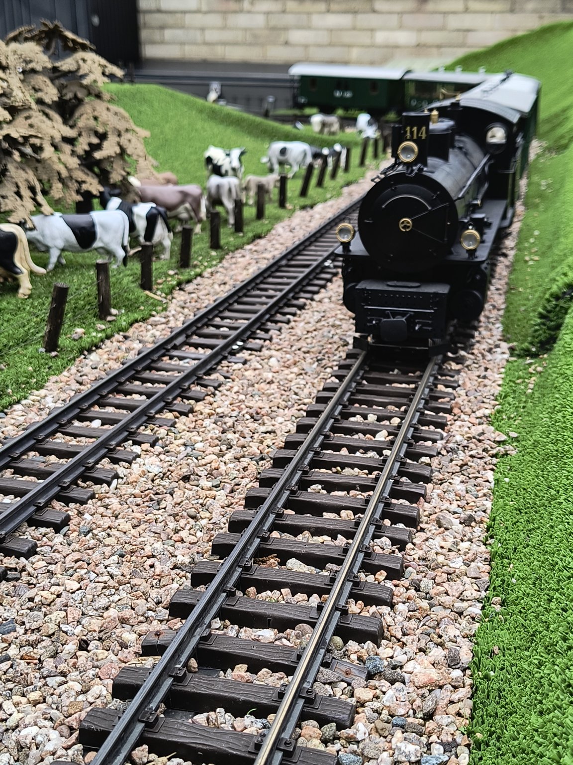

1000006036.jpgtanalised timber deck, heavy duty industrial weed membrane on top..fake grass and grit..
