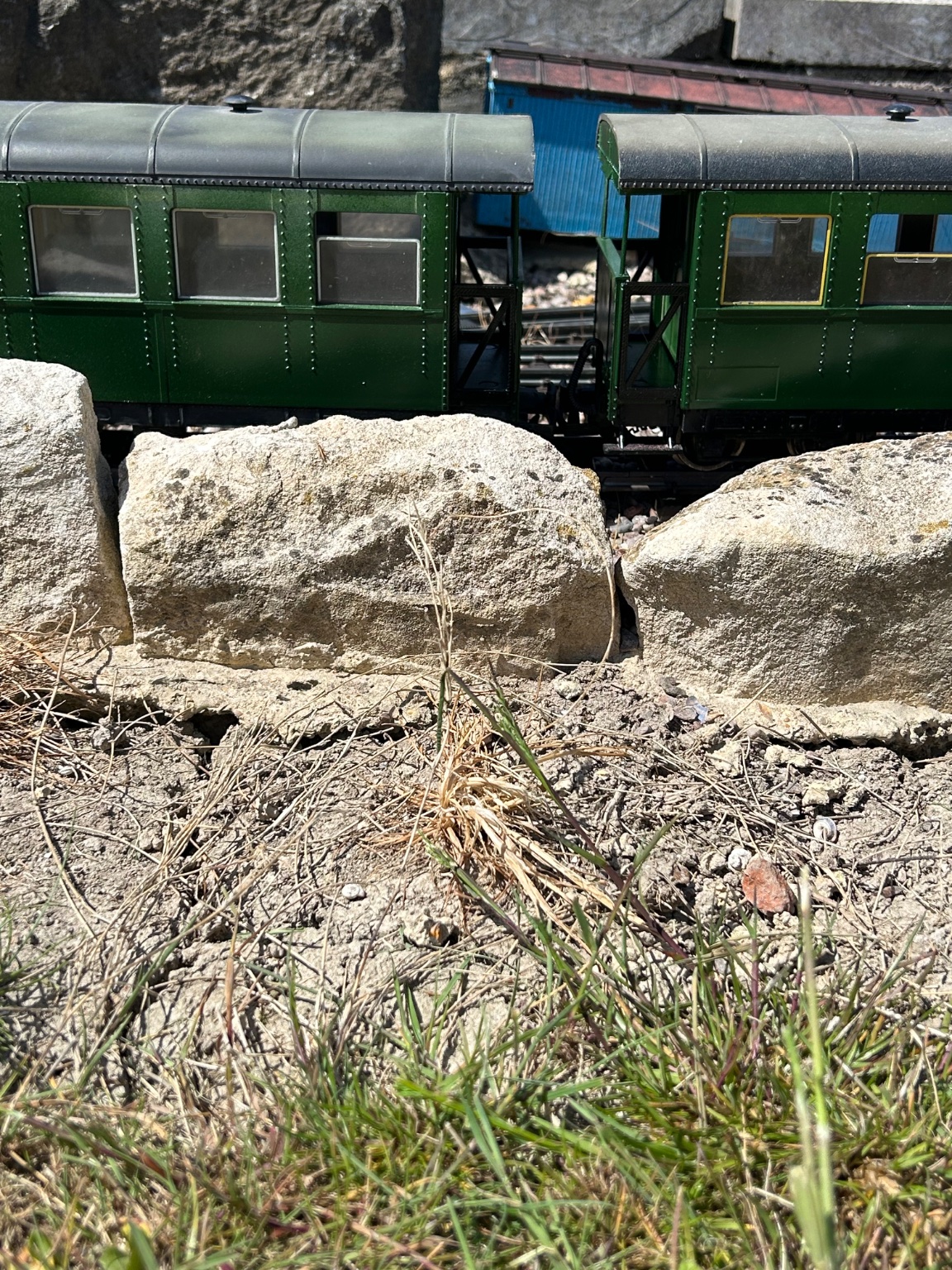

A small update, as I’ve been making slow progress over the last few months
I’ve done lots of pondering and thinking and a little doing,
I’ve decided the following:
all remnants of the corridor connections need to be removed and the residual gaps filled
Some sort of verticals support pole is needed between the roof and balcony
Plastic u shape styrene rod will give a nice finish to the balcony
The side doors on the balcony are undecided, it’s either mini chain or make 6 doors

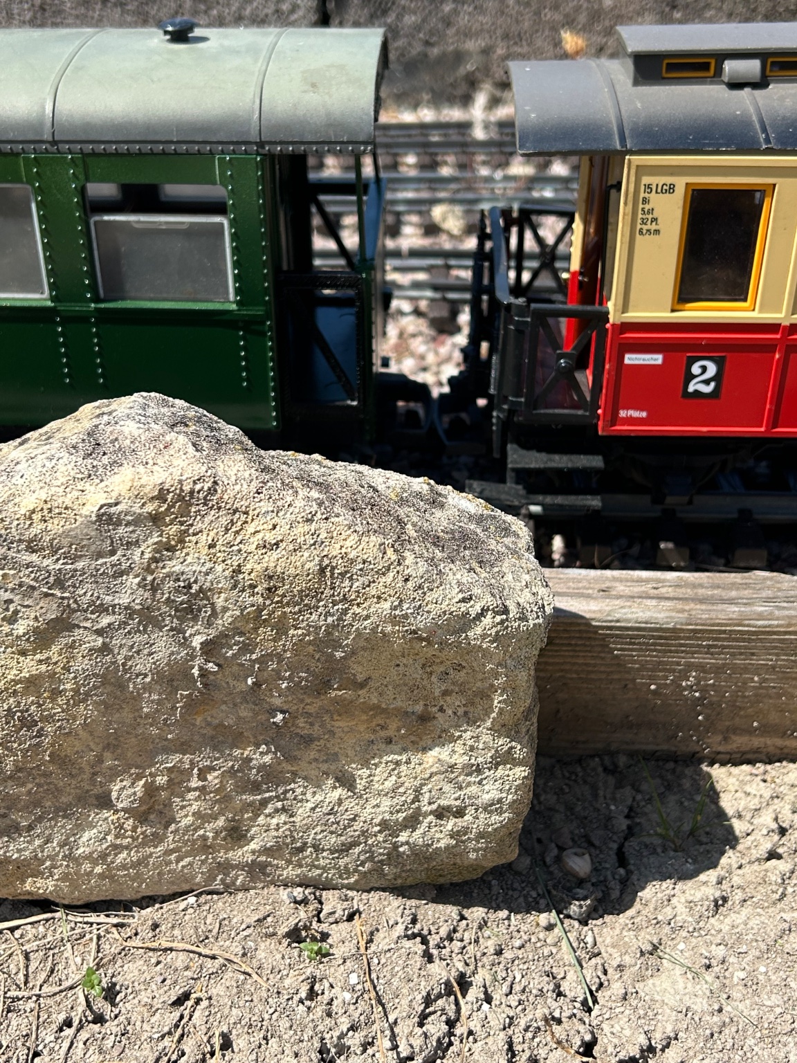

Another little photo update, I’ve been plodding along slowly,
Posed the coaches in some recent sunshine to decide what’s next.
I’ve ordered some 2mm rod for vertical supports between the roof and balcony end, I’m using carbon fibre rod for RC cars as it was cheaper than brass rod.
Hoping to give them a dusting of primer after that
Dan

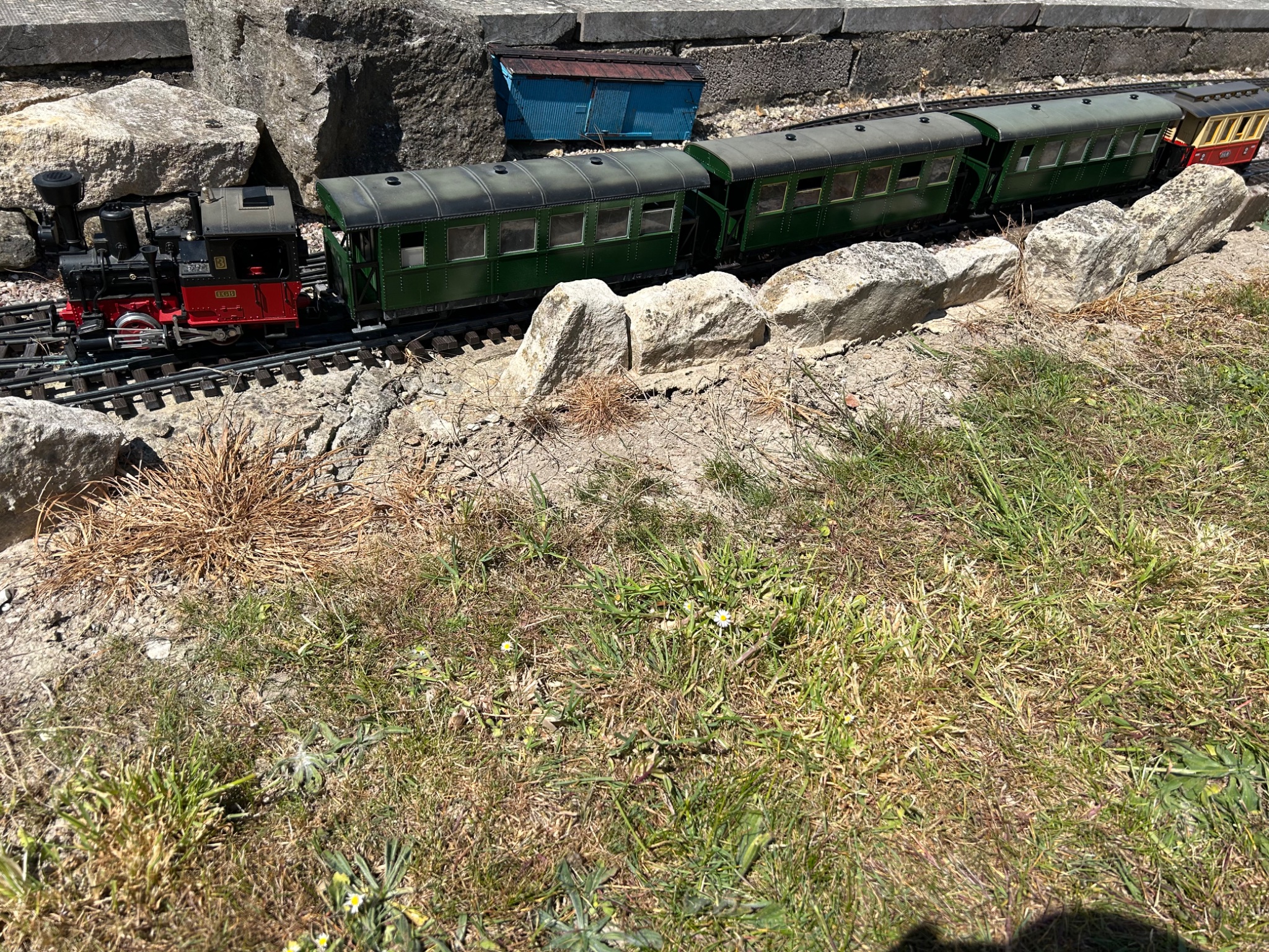

Latest update
In the recent sunny weather the coaches have had a coat of primer, they need any final touch ups and choosing a top coat colour.
I currently can’t decide between a bright red like the rhb red or some sort of green the hardest part is finding a suitable spray can colour
Dan
