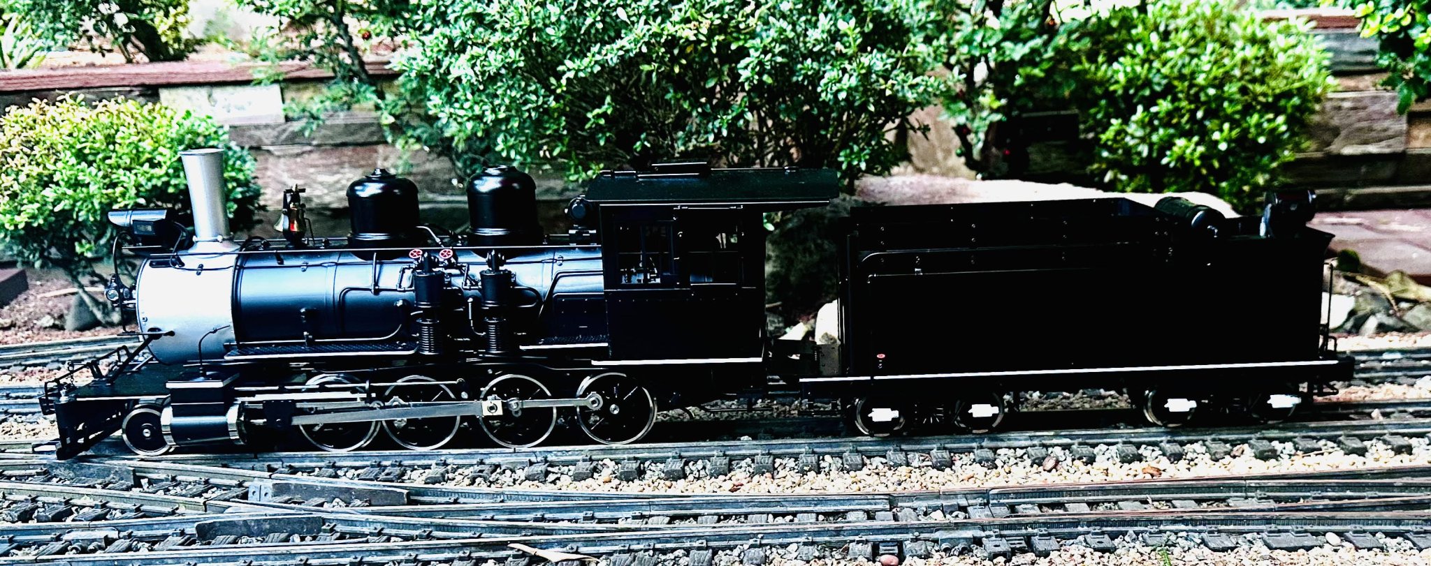

I converted mine but did use a 1400mah 4S lithium battery pack which slid into the boiler from the front. Gives quite a good run but haven't actually managed the current consumption. No problem with multiple two hour sessions of gentle running. Much easier if you can get your batteries into the boiler, no need to pull anything apart.
