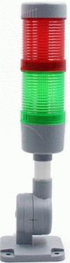

Must admit i have been looking at loads of ideas. A good one was the image below, but to far out of scale. Its about 10". But i will try it & maybe paint the casing black or dark green to tone it down. They are about £9 each & 24v led.
