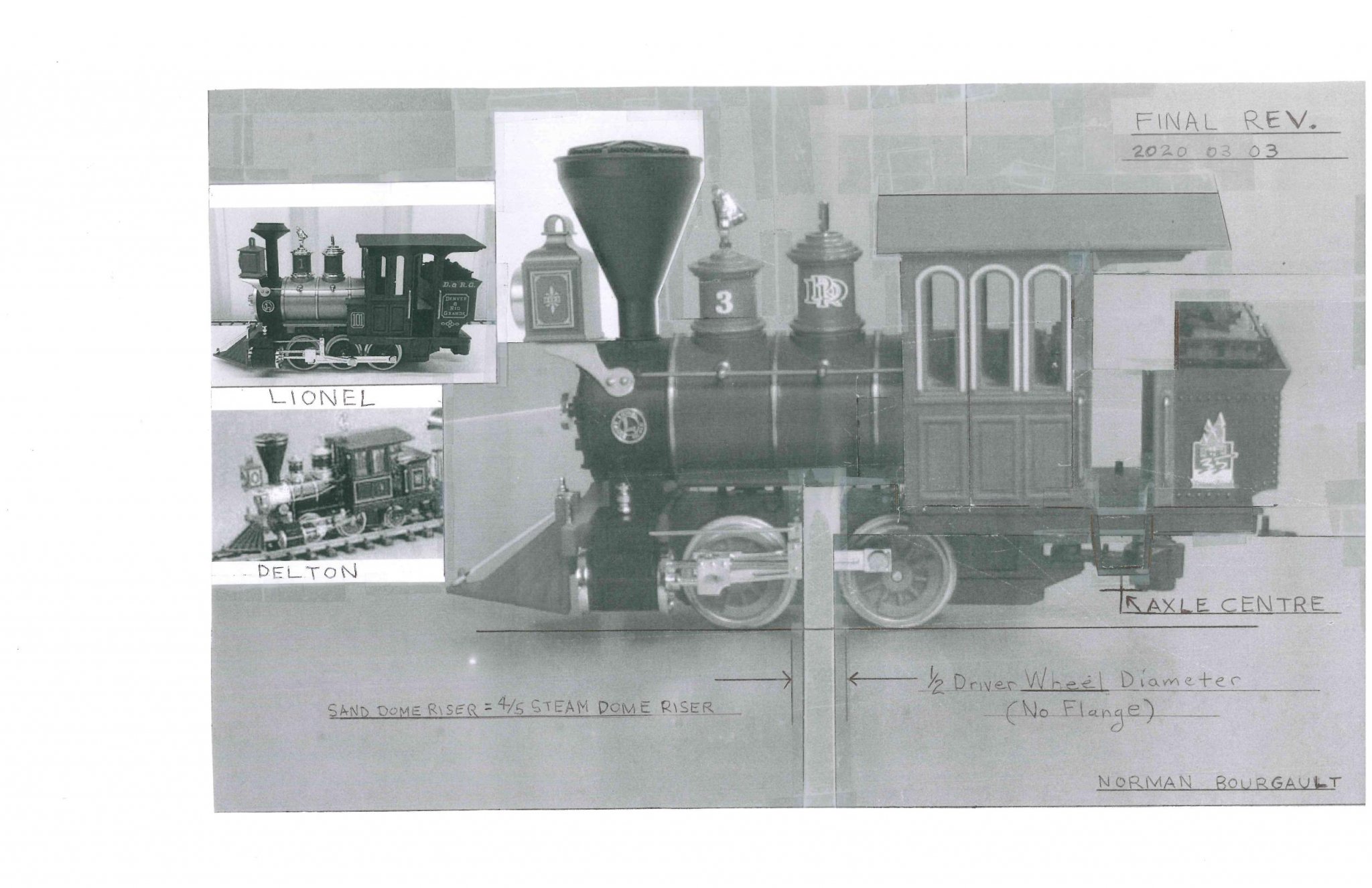

The NORMAN BOURGAULT Final Revision of the
LIONEL 0-4-2T with Smokebox of 2 Inch Diameter as the DELTON 0-4-2T with Smokebox of 1.5 Inch Diameter.
The Bunker must be moved further forward to be flush to the Front Edge of the Bunker Vertical Handrail.
I will Laser Cut the New Wood Cab with the C P HUNTINGTON Style of the Cab Side Rectangular Squared Corners Two Window Panes.
The Arched Tri Window Pane Design is also attractive.
The Replacement of the LIONEL Sand Dome & Steam Dome with
the BACHMANN COLUMBIA Sand Dome & Steam Dome would
provide an even closer match in appearance
of the LIONEL 0-4-2T Conversion to the Original DELTON 0-4-2T.

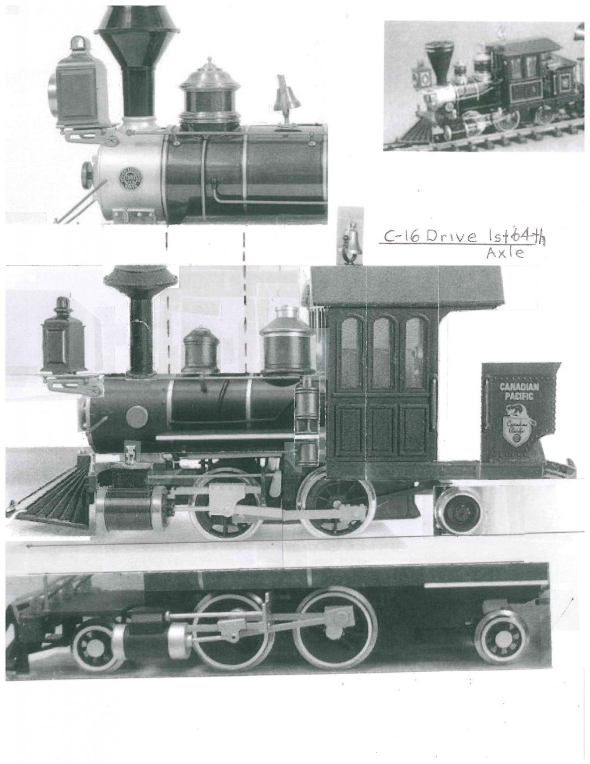

The BACHMANN COLUMBIA 1.75 Inch Diameter Boiler will Mate with the
HLW Flat Panel Roof Cab IF Horizontally Compressed to 3/4 of the Original Factory Length for
an appearance similar to the DELTON 0-4-2T " LOOK " using either
the BACHMANN COLUMBIA Drive with the C-16 Steam Cylinders
Inline image
or the Custom Drive built of the 1st & 4th Axles of the DELTON C-16 Drive.
Inline image
Upper Drive: The Custom Drive built of the 1st & 4th Axle of the DELTON C-16 Drive.
Lower Drive: The BACHMANN COLUMBIA Drive.
